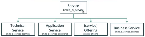

As per CSDM 4.0, should we not populate any data in 'Service' [cmdb_ci_service] table right?
Suggy
As per CSDM 4.0, should we not populate any data in 'Service' [cmdb_ci_service] table I believe?
We have a new Vancoucer instance with Demo data loaded and I see there are many records in cmdb_ci_service table.
Is ServiceNow still using wrong Demo data? or am I missing something?
marcelhorn
Your statement is correct but keep the hierarchy in mind.
According the table hierarchy you´ll "see" all Business- / Technical Services / etc. in the [cmdb_ci_service] table. This is also true even if you using the correct Business Service table: [cmdb_ci_service_business]
Please use latest SN products like the SPM Service Builder or the Digital Portfolio Management Plugin to put your records into the new extended tables by default.

l337
CSDM requires us to populate application services in either the cmdb_ci_service_auto table or the cmdb_ci_service_discovered table.
An important thing to note is that when a CI record is created in either the above tables, a CI record also gets created in the cmdb_ci_service table.
CI records can still be created in the cmdb_ci_service_auto table however, eventually you will need to use the button "Convert to Application Service" on the CI form to have it populated as an Application Service in the cmdb_ci_service_auto and cmdb_ci_service_discovered tables. If you go this route, the CI will still exist in the cmdb_ci_service_auto table.
If you convert a CI from the cmdb_ci_service_auto table, the CI created in the cmdb_ci_service_auto and cmdb_ci_service_discovered tables will be classified as Calculated Application Service CIs.
If you create an application service CI in either the cmdb_ci_service_auto or the cmdb_ci_service_discovered tables, they will be classified as Mapped Application Service CIs.

l337
This statement is wrong "CSDM requires us to populate application services in either the cmdb_ci_service_auto table"
Its just a parent table/dummy table. Nothing should be created directly on that table.
I got above response from ServiceNow when I raised a support ticket.
Hello Suggy,
If nothing should be created directly on the cmdb_ci_service_auto table why does ServiceNow allow us to create new Application Service records on that table? If it weren't allowed it should not be possible but it is possible.
