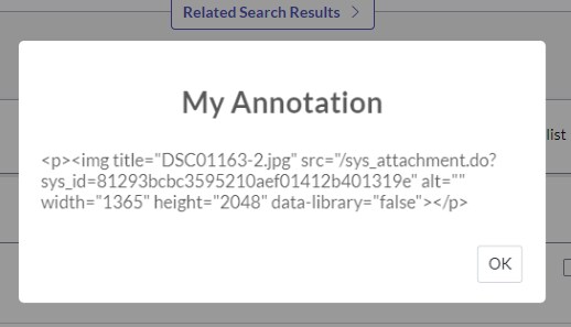

I have sweetalerts2 servicenow share update set installed and this updated set. However in the form view I'm still getting this - > see image.
and not the actual picture? Any help would be great. Also none of the sweet alerts buttons / images are working on the form view. That picture is about as dynamic as it gets on the pop-ups.
