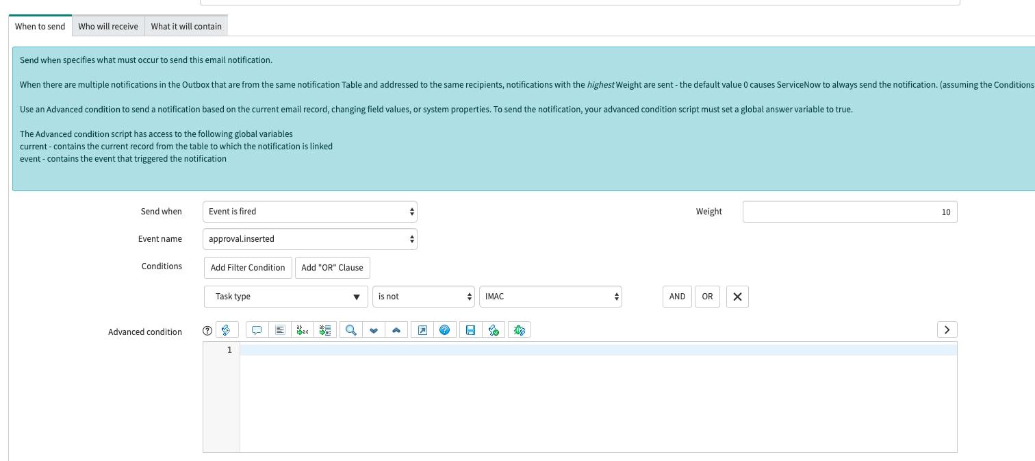

I got the notification condition task type:
on the oob approval email notification i use task type not 'mycusttable'.
i create a new notification,
table is mycusttable
event is approval.inserted
and it uses my new email template.
the approval records are created correctly,
BUT
the email is NOT sent.
am i doing something wrong?
