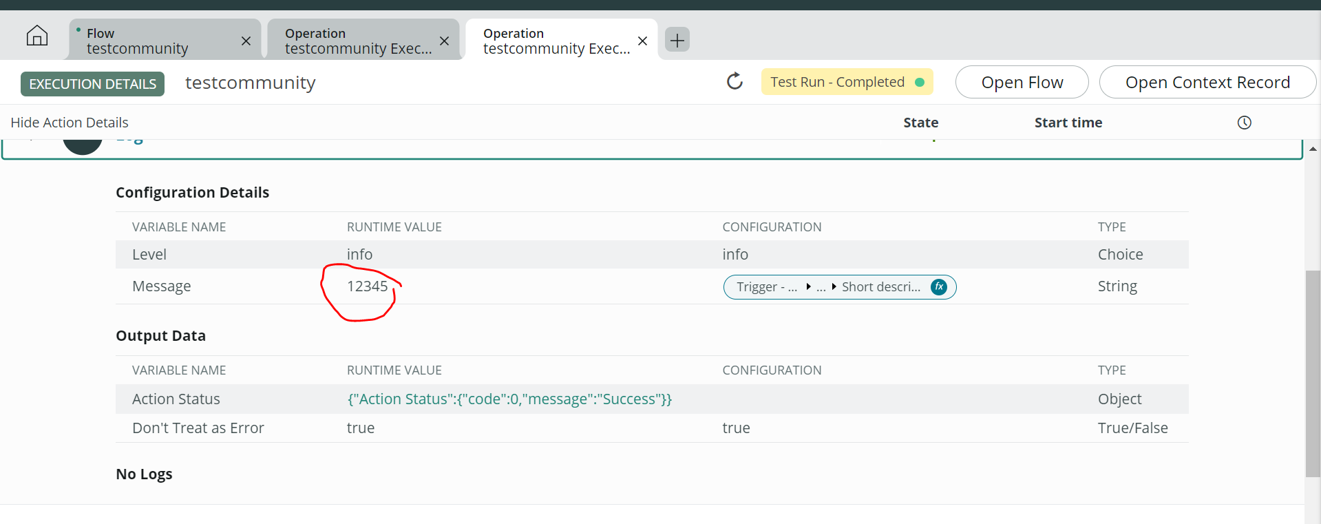

I figured it out
You need to use math function -> Absolute value, it converts 0012345 to 12345

03-18-2022 10:21 AM
I figured it out
03-21-2022 07:28 AM
It worked wonderfully, Thank you Anil!
