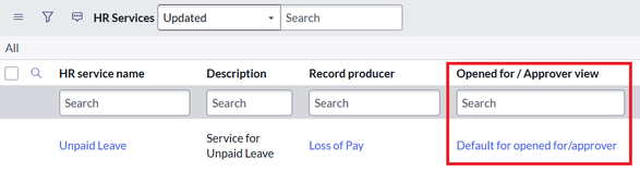

‎08-24-2025 10:30 AM
Hello @tahnalos
To meet this requirement
- Navigate to the sn_hr_core_service table and locate the field "Opened for / Approver view".
- Open the referenced record in this field.
- In the Person row section, you can define which users should be shown in the person row.
Please note:
Each configuration can be linked to multiple HR Services. Any changes made to this record will reflect across all HR Services associated with it.
If the configuration should apply only to a specific HR Service, create a new record in the sn_hr_core_config_case table and relate it to that HR Service.
Result:
Hope this helps!
