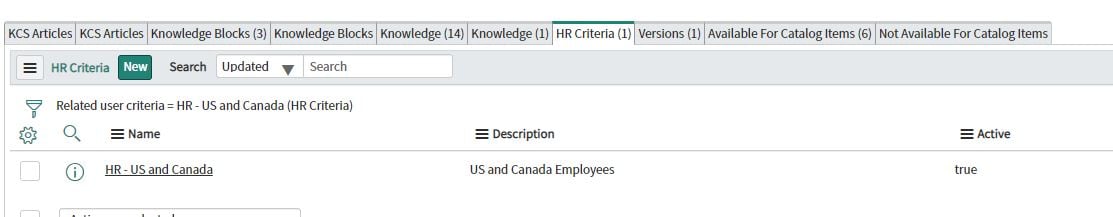

Here is one example of an hr criteria:
Then uses a condition:
Let me know if you would need to see the actual condition, but here it is:
Hope this information helps - please let me know if you need more.
