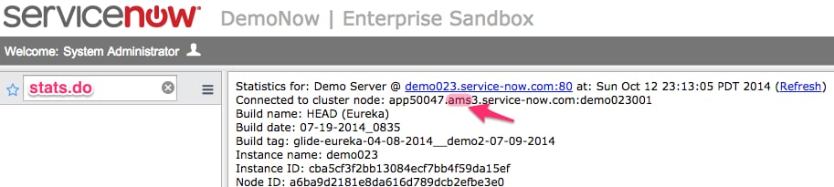

How to tell whether a ServiceNow instance is onpremise or on oncloud?
Mujtaba Amin Bh
Mega Guru
lhr3 is serivicenow.. I got the same clusternode: .lhr3.service-now.com
9 REPLIES 9
It should be just below the line you pasted after you hit stats.do
Connected to cluster node: XXXXX
-Anurag
From Tony's eg you can see that the clusetr node is
cluster node: app84046.sjc4.service-now.com:XXXXXXXXXX
the trailing XXX.service-now.com tells you whether this instance is on SN's cloud or on premise. I work on an onpremise instance currently and i get my organization's server name there.
-Anurag
Goran WitchDoc
You can always see where the instance-url goes to. If it goes to service-now or the company servers?
