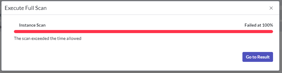

Need a way to stop the full we started on the 'Instance scan'.The scan generally takes 10 to 15 mins but it's been running for hours and is stuck.Need a way to stop it.It's not listed even in the active transaction on the platform so that i can kill it.

Though can you open the Scan Result record, and copy the "progress_id" value (for example look at the XML). Then within the Progress Worker table [sys_progress_worker], search for a record with sys_id being the progress_id. The Progress Worker record, is it still in state Running?

Not sure if you're situation is exactly the same, though tried reproducing.
With the Process Worker record, you should be able to find the Schedule Item (maybe there's an easier way, haven't looked that much):
If you would open the related record under Job ID, and kill the background process, the Scan should stop.
(the message about exceeded time is incorrect)

This is what i see on the progress worker record
