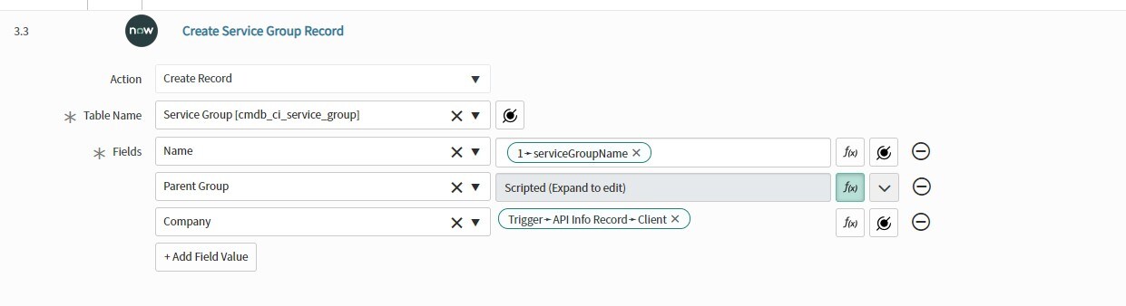

  1. Create Service Group (cmdb_ci_service_group)

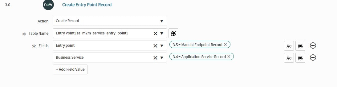

  4. Create Entry Point (sa_m2m_service_entry_point)

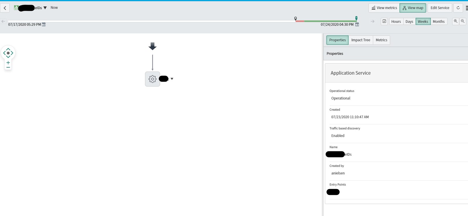

Here's the map:
