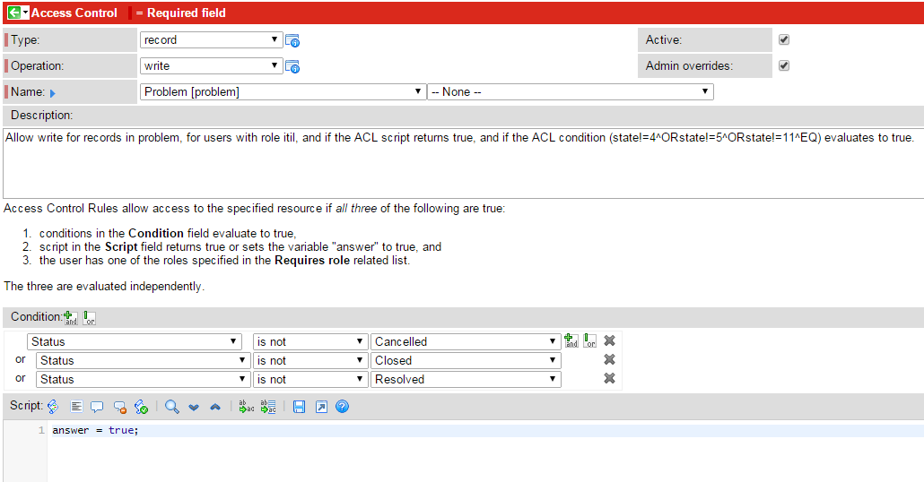

In our project, we have written an ACL for allowing permission to edit all variables in the problem when the state is not Resolved, cancelled or closed. Now we have a requirement that we need to give access to edit a single field even after Resolved state. I tried by writing another Field ACL but it does not work. Since Field ACL will work first and later the table ACL will work. Can anyone help me for this ?

You must have a table.* acl already for blocking the access.. Create a field level acl for the needed field and it should do the job
‎02-06-2015 02:02 AM
Field level access controls have a higher precedence over table level.
Kalai's solution is right, if you are not able to implement then show the ACL that you have for restricting and we might help to create a new one

Create a * acl blocking the access .. Then create a field level and see if it works for you
