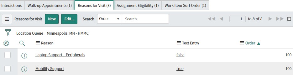

There can be additional text box shown below the selected reason.
So to solve your problem you can add a reason other and then you set the text entry to true like below
Which would look like below
