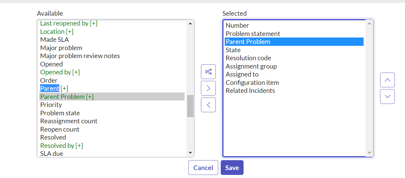

Hello Kingstan,
To achieve this you can go to System Definition --> Relationships. Click on New button:
Create a new record as shown below:
Put the below script in Query with field on your record :
(function refineQuery(current, parent) {
var parentProblemID = parent.getValue("parent");
current.addQuery("sys_id", parentProblemID);
})(current, parent);
Go to the problem table and open any child problem record. Right click on form header go to Configure --> Related Lists
Search Parent Problem under Available section and move it to selected section and click on Save
You will now see the Parent Problem related list which will show the Parent Problem.

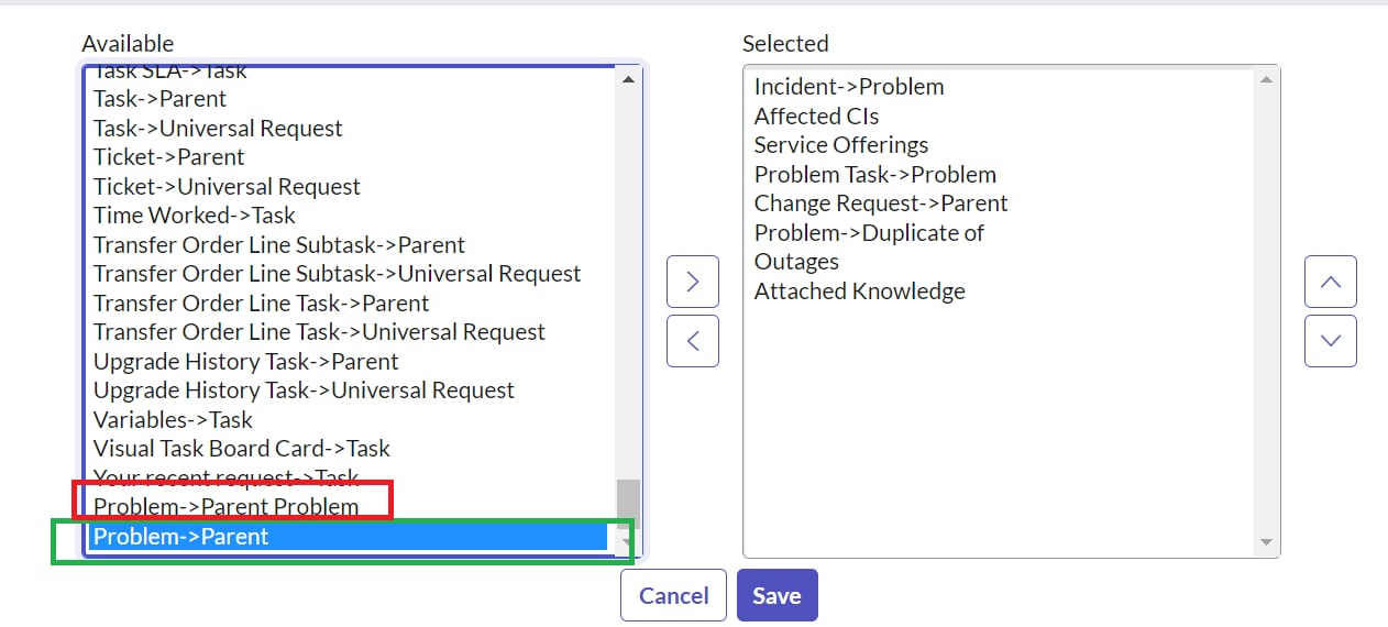

Try following steps:
1. Right click on header of the record and configure "Related Lists"
2. Select Problem->Parent and NOT Problem -> Parent Problem
3. Check the related list:
Please mark the answer as correct if it helped.
Thanks.
‎09-02-2022 10:13 PM
Hi, Your correct. But my objective is to have child problem relationship as you can see, The parent problem relationship is already established in the related list.
