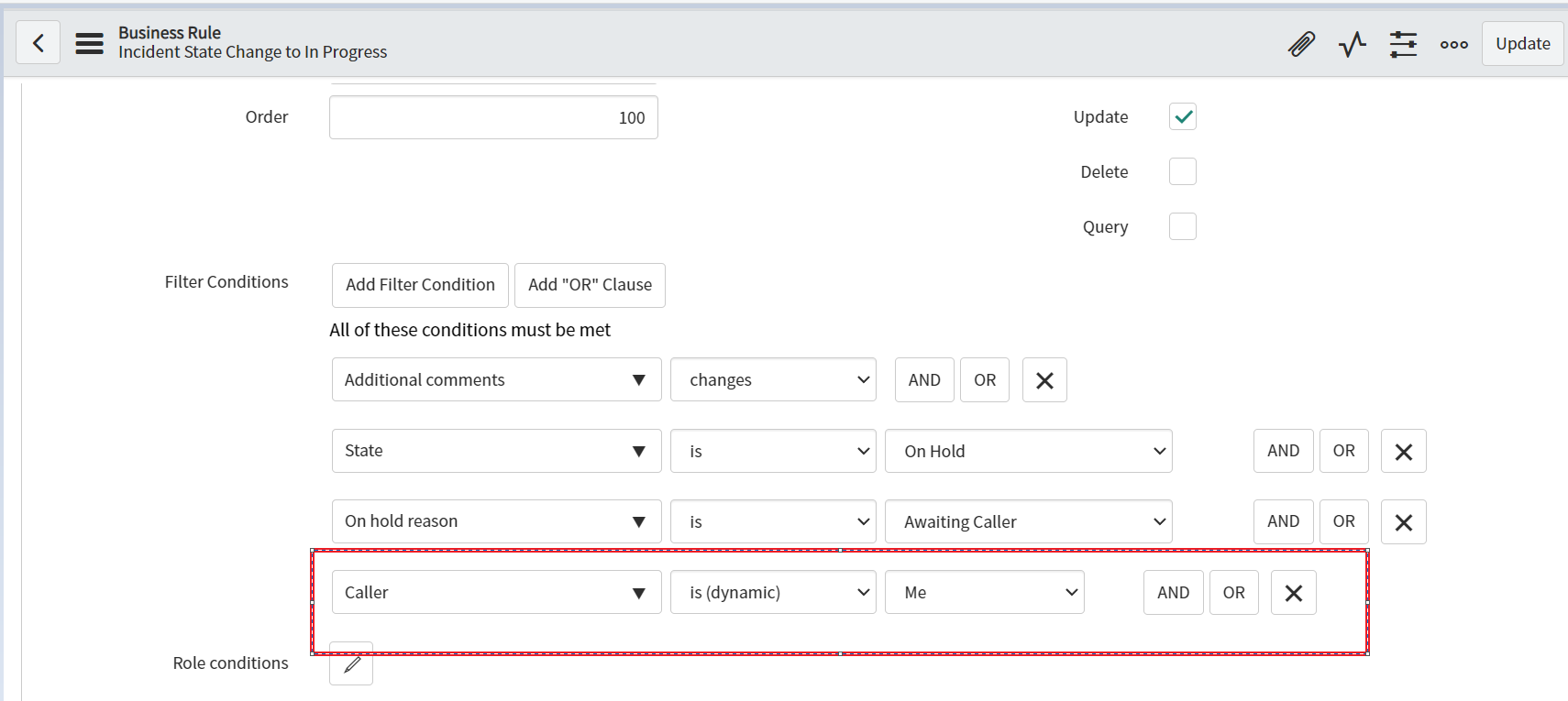

03-01-2022 08:58 PM
Hi
Just tested on my PDI, when Comments are updated by Caller, On Hold reason gets cleared automatically and state is set to In Progress.
For your query "However, after the Incident goes to 'In Progress' State, we cannot choose 'On Hold' state and 'On Hold Reason' of 'Awaiting Caller' again, because the 'On Hold Reason' still has the value in it, and when saving it flips back to 'In Progress'."
This is an expected behavior as per the OOB Business rule on Incident table named as "Incident State Change to In Progress" which you have highlighted in your post above.
It will not allow to update the state back to On Hold if caller of the Incident is same as current logged in User which is being checked in the BR condition as shown in Red below:
You need to remove this condition to make it work or modify as per your need.
Shloke

03-03-2022 07:23 AM
Hi
Please see my response above, I have not suggested to change the order of BR or a action.
I am saying you need to remove the condition which is highlighted in Red above by clicking on the cross symbol i.e. you need to remove the condition which says "Caller is (dynamic) Me".
After removing it save the Business Rule and then try again. It will work.
Shloke
03-04-2022 11:50 AM
Hello
I tried changing the BR 2 different ways as follows, and impersonating a user to enter an incident, and still no luck...
1st - removing the 'When to Run' condition of 'Caller is (dynamic) Me' and adding the 'On hold reason to None' Action:
2nd - removing the 'When to Run' condition of 'Caller is (dynamic) Me' and without the 'On hold reason to None' Action:
Thanks for your assistance thus far.
Any other suggestions?
