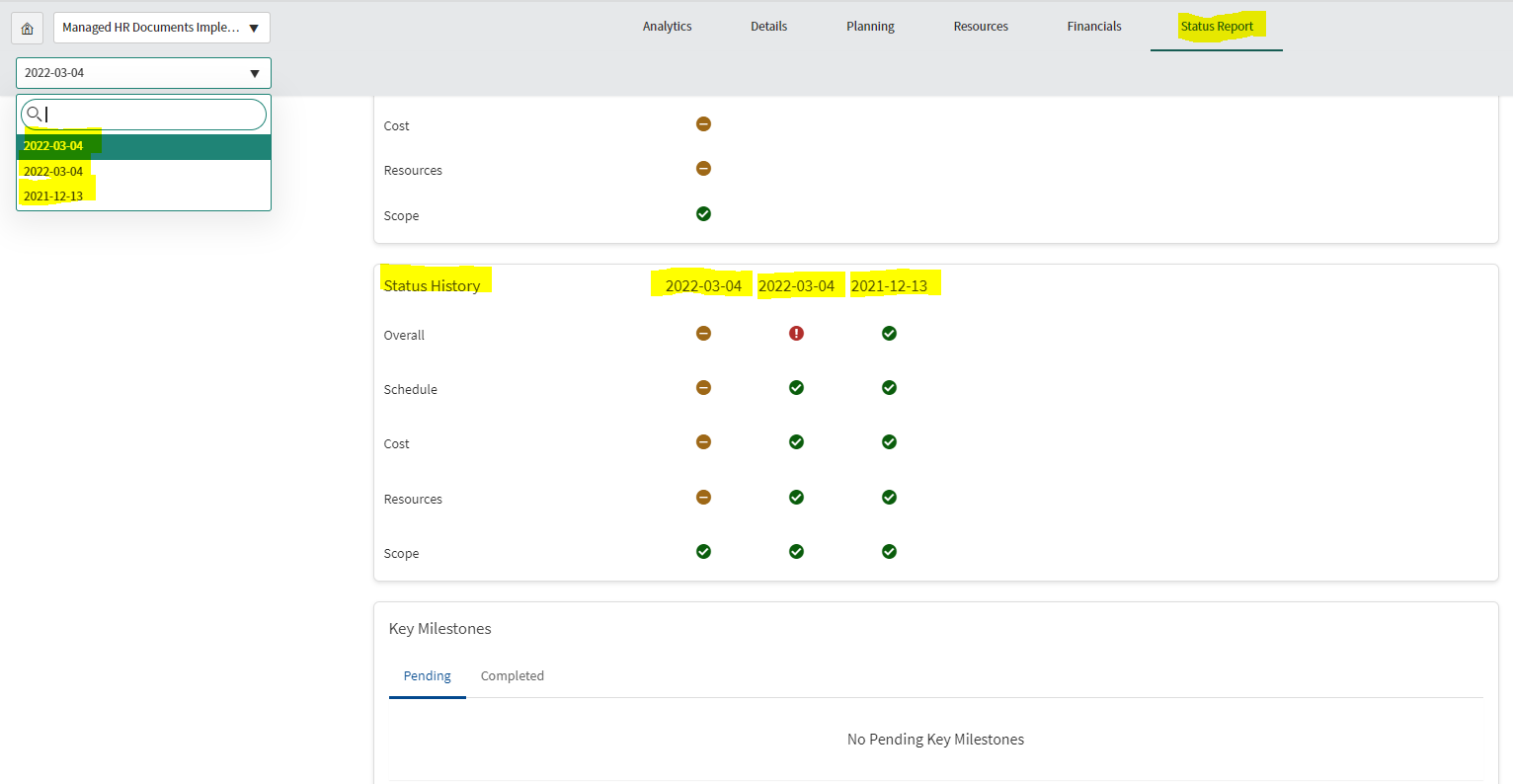

I want to create a trending report for projects that shows when a project goes from one overall health state to another (i.e. Green/Yellow/Red).

Hello BradDavis,
You do not need to create a separate report for this, As status history already available (OOTB) under "Status history" when you scroll down the status reports which indicates when overall health state changed from "Green" to "Red" etc with dates.
Please see below screenshot..
Please Mark Correct/helpful, if applicable, Thanks!!

Hello BradDavis,

I had a similar question to Brad. My customer wants to see a list of projects each week that have changed color since the last status report. I don't know how to do the following:
1. isolate the current and previous status reports
2. compare the overall status of the previous and current status reports and only show those that have changed color
Any help would be appreciated. Thank you!
Hi @Sulabh Garg, do you happen to know how to have this "Status History" displayed in the project status report (PPT)? Thank you!
