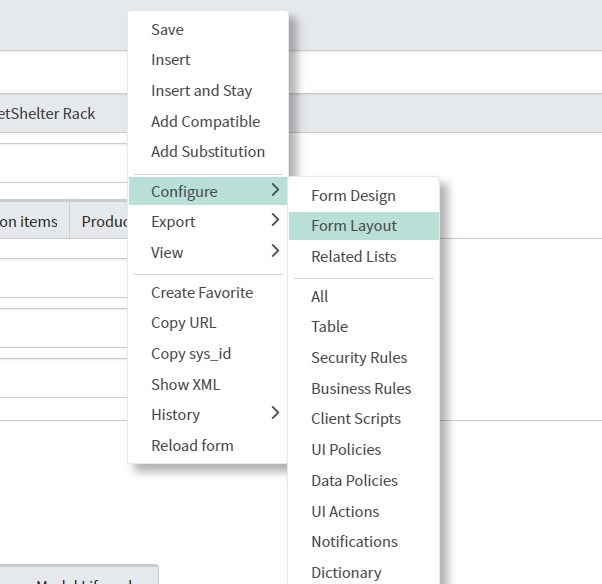

Please follow the below steps:-
Go to the hardware form
right click on the top -> configure -> click on form layout
Once the form layout opens click on the information section
The selected portion will show all the fields already present on form
In the portion of create a new field , put the name Form factor and then click on Add
Once Add is clicked the new field will show in the Selected portion put it above the end split and then click on save
Then you will see the field on the form
Now to add the options right click on the field name-> configure dictionary
Then once dictionary opens scroll to the bottom you will have choice option must create the choices and in the choice field select dropdown with none so that the none is also an option

I'd push back on the customization if you are using HAMP.  HAMP introduced a field called Device type (cmdb_hardware_product_model.normalized_device_type). This field is a reference to the sn_hamp_hw_device_type table which gets its options populated from the Content Library, but also allows user defined options to be added by clients.
Going this route you may need to adjust the acl that controls this field as it makes it read only if customers aren't paying for a certain device in their HAMP subscription (e.g. Mobile Device, End User Computers, Servers, Network Gear)
You'll also want to adjust 4 UI Policies on that make this field read only if the normalization is fully normalized or partially normalized.
