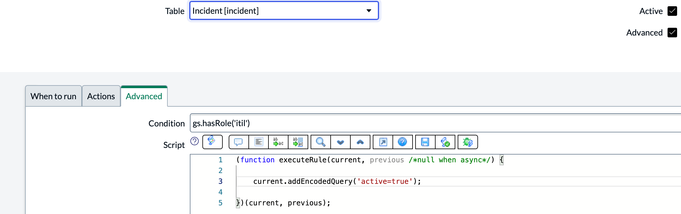

You shouldn't apply filter conditions to a query business rule as they will be ignored. A query business rule is generally used to force a filter to records for a particular user i.e. user with software role should only see incidents with software category
To achieve this you will need to set advanced to true on the business rule and in the script section, add the query you want to apply, see example below that applies the active = true filter to any incident record that an itil user (based on condition role=itil) interacts with
The article below gives a great explanation on how query business rules work
Hope this helps,
Shane
