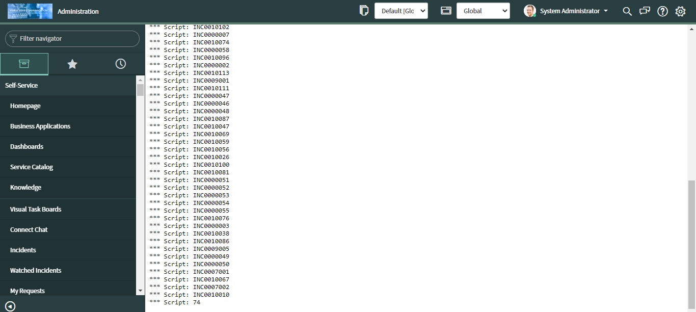

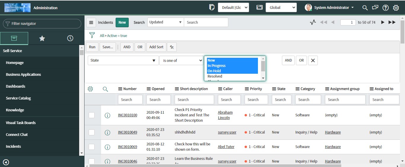

Hi
Your addActive Query gives you the records for which the below mentioned Active check box is checked i.e. True.
If we go to list view of your table. consider as incident table.
Type incident.list or incident.LIST in the filter navigator  and then add active is true you will see 74 records out of 103
this records are nothing but the records which are having the state either New or In Progress or on Hold only.
once the state of your incident goes to resolved or close the active flag becomes false.
add the filter below, you will get same 74 records as previous active true filter
in the script you can add this filter in two ways. either you can copy the filtered query by right click
and copy query and then add it to addEncodedQuery("paste your query"); or you can use addQuery('active','true');
one more way is to use addActiveQuery all these means same.
try this in background scripts
check the results
