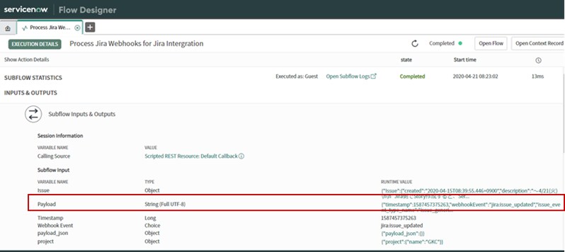

Create the field in Process Jira webhooks(Jira Spoke) that corresponds to that customized field.
Step1: To find the field name you want to customize from the log, click the payload [string_full_utf8]
 Step2: Create the field name in Process Jira webhooks page that you found at the Step1
