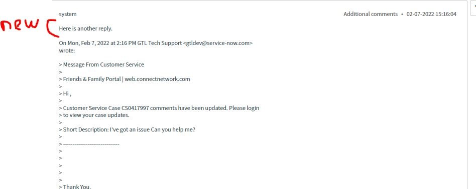

When we receive a reply email that updates an existing Case, the whole email gets written to the "Email Received" entry in the Activities log.  We want it to truncate it at the "From:" text, so only the actual latest part of the email is saved in the entry:
We assumed this is what the Active "Email Reply Separator"s should do, or have we misunderstood?  Our 3rd party consultants say this is not what they do, but the documentation seems to say they should do this.
We have the two default Email Reply Separator's Enabled, but when reply emails are processed, it is still putting the whole email chain in the Activity log entry, despite the reply having "From:" in the chain.  It is not truncating the email.
How do you get these to work?  Do we also have to add something to our Inbound Email Rules, or should it just work?

The email received record doesn't get any content removed, this is just a link to the email record. It's the additional comments that are created from the content of the email that get truncated.

Ah!  Thanks for confirming - the documentation does not make that clear.  We assumed this affected the "Email Received" record.
