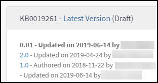

We would like to not advertise the authors/updaters/revisors of our Knowledge base articles on our Support Portal.
We are using article versioning and I have come unstuck when I try to remove the user from the Version text.
Here, I have blurred out the users, this is what we would like to remove.
I have looked into the HTML and believe this to be contained as part of version.versionText.
This also contains the date which we do want, so I don't want to remove the tag completely.
But can't find a way to edit the content of versionText.
Any ideas?

Hi Alberto
That removes the author from the header but not from the Version Info:

We have been told by Hi Support that hiding this information is not possible OOTB with Article versioning available.
However that it is possible to customize:
"The versioning details in configured with script include: "KBVersioningSNC". The portal widget code or the kb_view page both calls this script include for retrieving version related details. Also, it's having some dependency on OOTB internal code, so through customization also you may not get all features. But you can try checking the above-mentioned script include."
We haven't been able to test this solution.
I'm hoping we are able to do it in another manner by editing the CSS but will see once we've had more time to look into it further.
