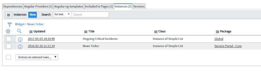

Check out the News Ticker widget. Under the instances tab, create a new one and add the widget in your SP accordingly. In my case, i created a new table and mapped it here. You could map based on your request.
This is how it will be when you create new.
 This is how it will reflect in the SP.

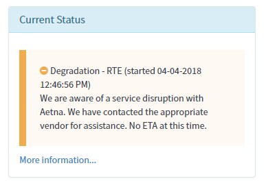

Allen Andreas
Are you referring to the Service Portal homepage?
If so, there is already a current status widget that shows outages/degradation/planned maintenance,. etc. For example:
What I've also done is when they go to submit an incident, on the SP form, I added it again at the top of the page...so they see it again.
So overall we have it on our login page, SP homepage, and on the page where they'd submit an incident too.
