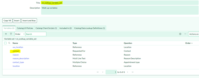

However, If I create a brand new Catalog item as suggested, I cannot see any variables for the "User Contact" field which is mandatory:
A 'user contact' variable has been created with the newly created catalog item, but it seems to be filtering it out...

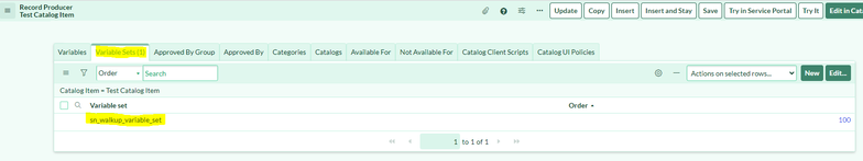

Nevermind, I was able to figure it out (though it is not well documented).
When creating the new catalog item, you need to include the OOTB variable set called "sn_walk_variable_set" which will include the user contact variable:
Michael H
Giga Guru
Additional note:
Make sure to include both variable sets (sn_appointment_variable_set & sn_walkup_variable_set), otherwise your appointment will not have a "window start"/"window end" date.
