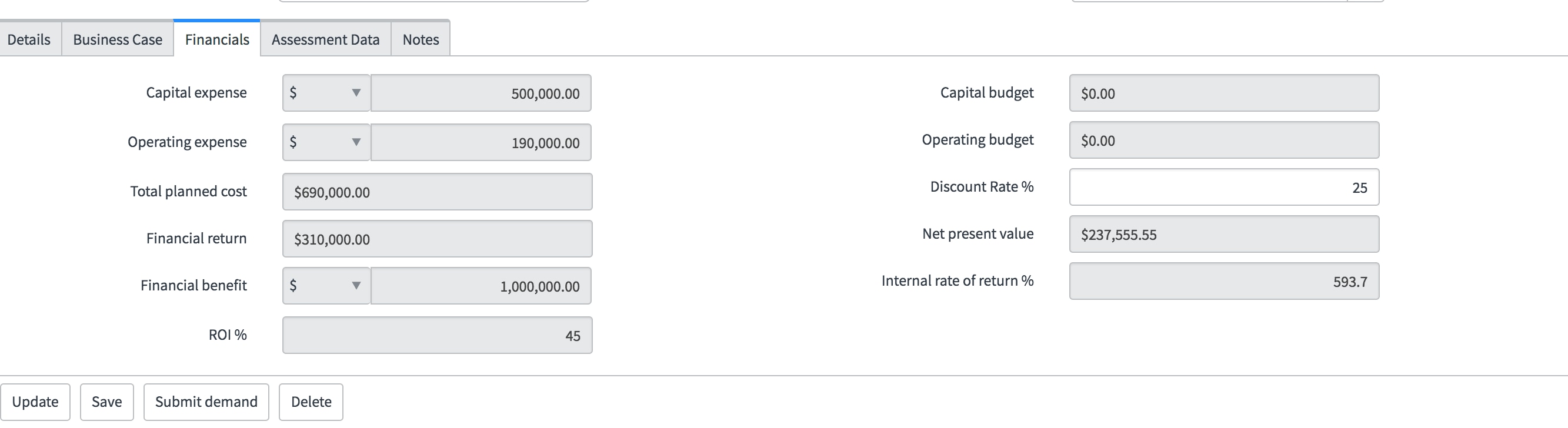

Can anybody please explain how financials are calculated on a demand?
How to allocate certain amount to the demand
How ROI% is calculated?
How net present value is calculated etc? Please explain these calculations with example.

Now I got the the fields populated. Its considering calculations only if the fiscal period is starting from FY19Aug or later not before that.
But the calculation is not matching.
Present value of the future cash inflows = 30000/ (1+0.10) = 30000/1.10 = $27272.72
NPV = PV-C = 27272.72 – 22000 = 5272.727272727273
But in system it shows 7161 which is not matching with the calculated result.

I was looking for the exact value with different duration. Can you do the maths with my example to get the exact value that is showing in the system??
