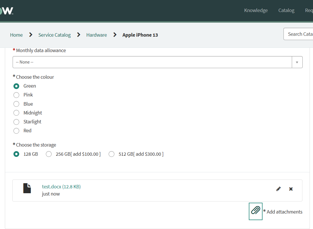

@BeateN
The problem I think is not with the Order Step, When the test run reaches the Add attachment step, I can see that the files get attached along with paper clip icon in a different way, the files do not get attached in that way when you attach them manually on the form.
See the screenshots for better understanding
