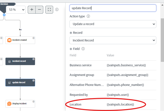

How do I create a incident block in virtual agent designer which should populate the location information based on the user (caller) ?
My incident block was creating the incident with location information blank on the incident form. I was able to update the Incident record with business service and Assignment group by getting the input variables from the calling topic and using the record action utility inside the block but Its not picking the location when I use the record action utility.
could you please help me overcome this road block? what are the possible ways to pull the information and update the record. I have attached my design here

The problem was with only few specific records which doesn't have location. Records with location information were auto populated. Hence, location information was asked from the user and used dynamic choice to select the location based on the input from the user ( uses location table ) and updated the record for the exception cases which doesn't have location.

if you choose user ( user table ) as the input variable for the caller, it should populate the information from the record or you could also ask the client about the current location and search in the location table to update the record. get the input for the incident block and pass the input to the components inside the block.
