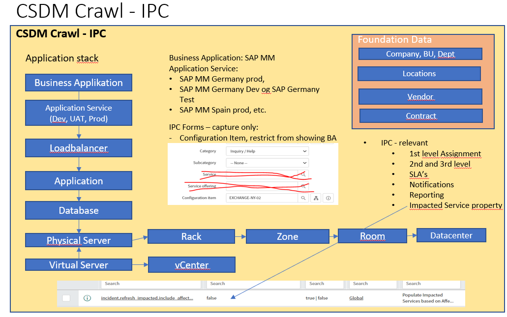

To extend what others have said: We have the same use case as you (and many others I'm sure). To account for this we use a combination of AS and BA to determine the priority of issues. If it is a business critical application and production it has different SLAS than those that aren't and it also affects what can be set for impact and urgency. As far as downlime components where you have redundancy, if I recall correctly you can deal with this in the Event Management Dashboard by indicating how many components of a cluster affect up line impact. Steve

Option 2:
- You will never have Versions, Environment etc. in the BA, this is a meta record for applications supporting a business capability.
Wrt: Business criticality - be aware of that on BA, they only use - High - Medium - Low and on Services they have 1-4 or 5, so I don't know why this inconsistence, but agree the criticality differs depending on environment, unless all environments is external exposured ;-).
Remember though, in BA, you can have a hierarchy, using the platform host value and link BA's to a platform ->
