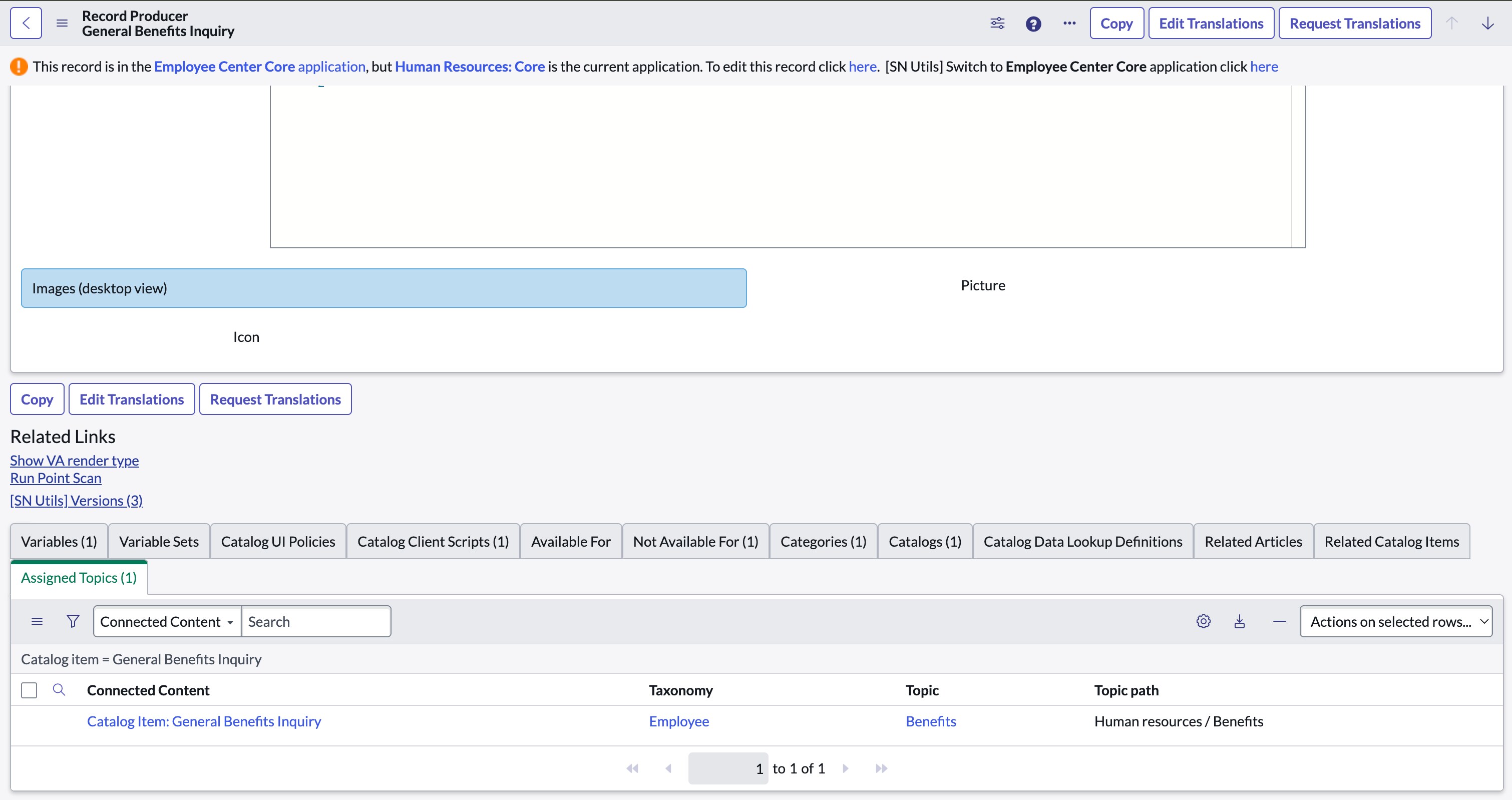

Case 2 – Moving for Record Producer
Let's say you have a Record Producer (e.g., General Benefits Inquiry) in the Human Resource: Core application. You've already captured it in an update set (e.g., ABC_GeneralBenefitsInquiry) in HR: Core, but notice that the connected content isn't included. To capture this:
1. Create a parent batch update set (e.g., ABC_ParentUpdateSet).
2. Create another update set (e.g., ABC_ConnectedContent) in the Global application.
3. Navigate to your Record Producer (General Benefits Inquiry), go to the Assigned Topics related list, and open the connected content record.
4. From there, use "Add to Update Set" to capture it in ABC_ConnectedContent.
5. Add both ABC_ConnectedContent andABC_GeneralBenefitsInquiry as child update sets under ABC_ParentUpdateSet.
6. Mark ABC_ParentUpdateSet as complete (this will also complete its child update sets).
7. Finally, move the update sets to your Test/Prod instance either by using “Retrieve Completed Update Sets” (All -> System Update Sets → Update Sources) or by exporting/importing the XML.

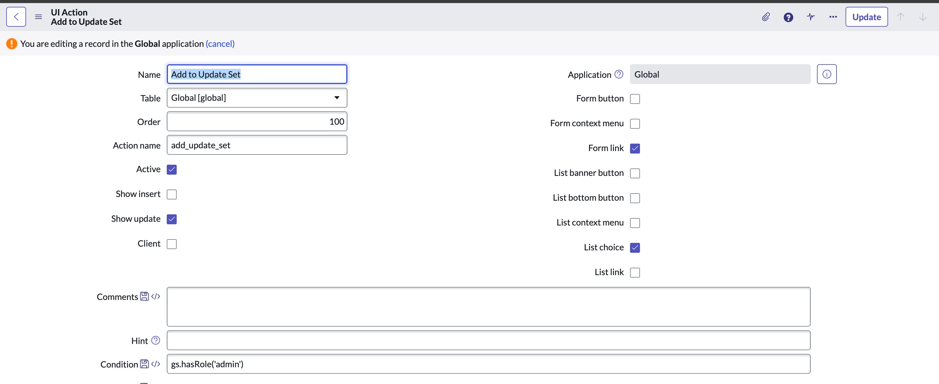

NOTE : The "Add to Update Set" is a custom button and can be made by using UI Actions as shown in the image.
And the script for it is :
addToUpdateSet();

You can also visit here for more details on "Add to Update Set" UI Action.
