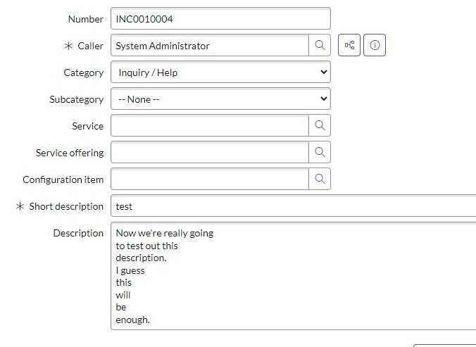

I was able to find where to set the Show 'Description' to Always. However when you look at the description in the service portal it does not keep any carriage returns that were put into the description field.
As can be seen above in the ITIL User view there were carriage returns put into the description field, however they do not carry over into the Service Portal view.
Does anyone know of a way to set it up so that it keeps the formatting?
