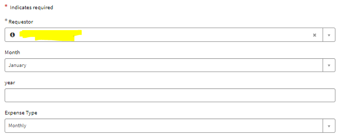

I have this Catalog Client Script that is supposed to populate 'year' field on the catalog item form.
What am I doing wrong as I do not see the field populated?

Hi @hadron_collider ,
If your expectation is that for the year to auto populate in the portal, you need to change from UI Type: "Desktop" to UI Type: "All", so it runs in all the UIs including Portal.
If that doesn't do the trick, other thing to check is if 'year' is really the name of your variable and not only the 'question'.
If that helps please mark my answer as correct / helpful!
And if further help is needed please let me know
Cheers
