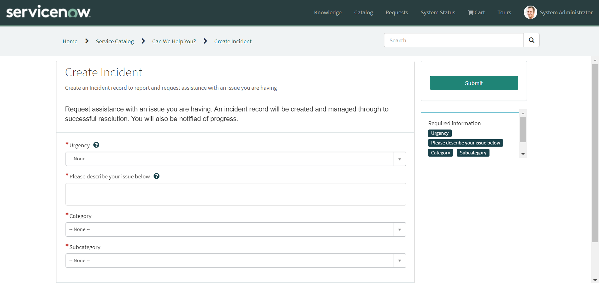

I have two fields:
Category and Subcategory
The subcategory field depends on the category selected.
This dependency is set in the incident form and works perfectly.
But I need that to work in SP too.
Thank you in advance.
