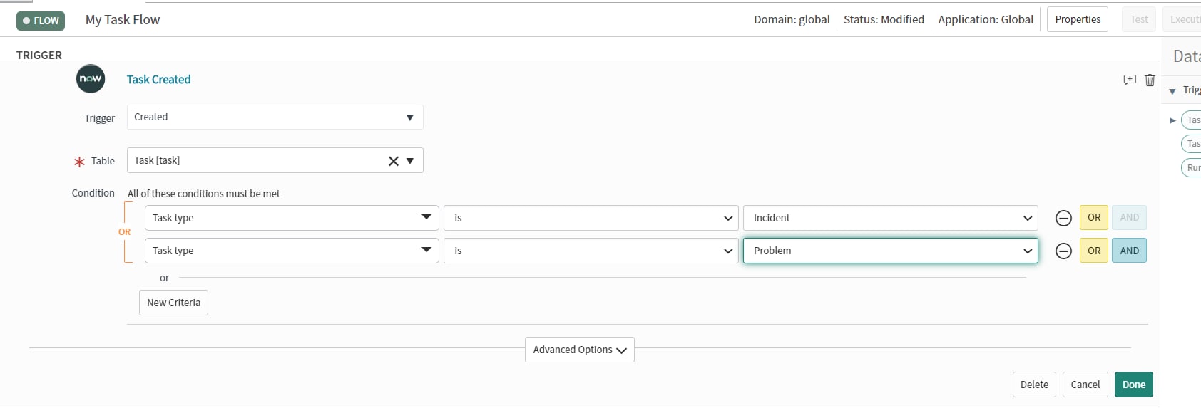

When you create flow on task table there you can give condition as
Task Type -  Incident
Hi Ankur,
thanks for your answer, but I think this won't work.
From my experience the condition is not evaluated if the changes are done in a different table from task e.g. incident. (I haven't tested your suggestion specifically though)
Pradeep Sharma
Hi Tim,
Starting with Paris release, A flow could be  triggered on the extended tables. Details here.
https://docs.servicenow.com/bundle/paris-servicenow-platform/page/administer/flow-designer/reference...
