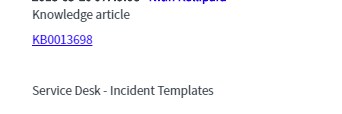

Your information really helped me a lot and understood the current functionality. However I'm stuck at one point. Do you know where the hyperlink/URL for the KB number is being configured/set? Currently once the KB number is updated to the comments field of Incident record, onClick of the number it takes us to a page/ESS portal which we are no longer using it. I want to change the redirection of the KB to our SP view.
When I was checking the 'KnowledgeAjax' script include I found the below piece of line
This is exactly how our comments field (Incident form) is updated with the KB article link
I also noticed one thing, when we click on 'Attach to Incident' button I can see an URL is being formed in the comments field, I think that is the link to be modified but I was unable to capture as it was visible onLoad and disappeared immediately.
Any idea where can we modify that link?
Thanks in Advance!
‎05-10-2018 07:23 AM
Probably the below highlighted link is what I would like to modify and update with our SP link.
