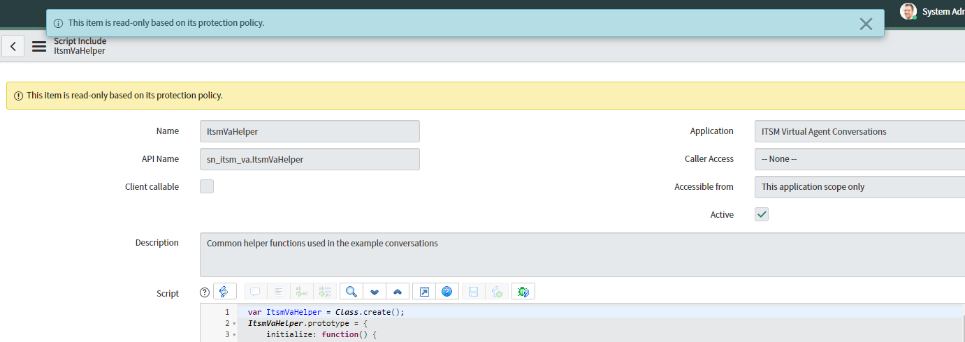

‎08-21-2020 12:56 AM
Hmmm this is not enough I think. Looking at that Script Include:
So I guess from Global you also can't access the Script Include.
You could try creating an extended Script Include from this one, in Global, so you can call the Script Include in your topic which is in the global scope.
