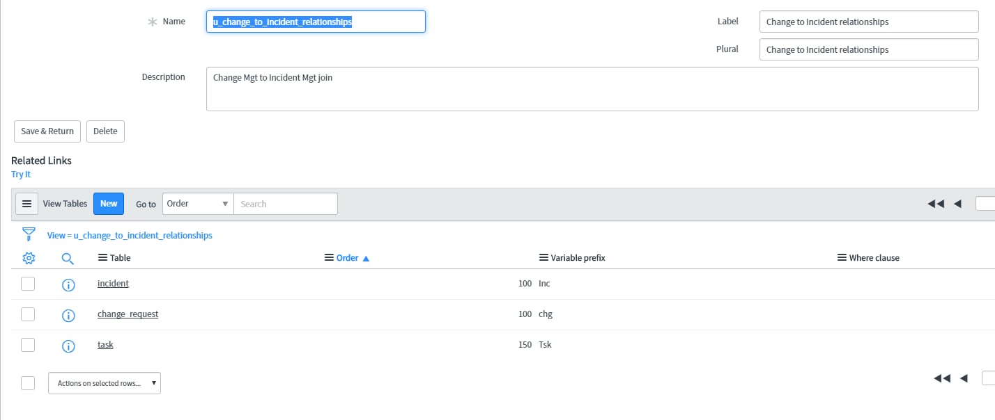

I then thought, maybe I need to create a database view, but after reading the wiki & watching a couple videos, I'm still unsure as to where & how to link the tables.Here's what I have so far in my test instance:
My thought process is that I would need all 3 tables specified because "Caused by Change" exists on the Incident table, and the "State" field on our Change_Request forms appears to be coming from the Task table.   Hopefully, I'm over complicating this & someone can propose a much simpler solution.
