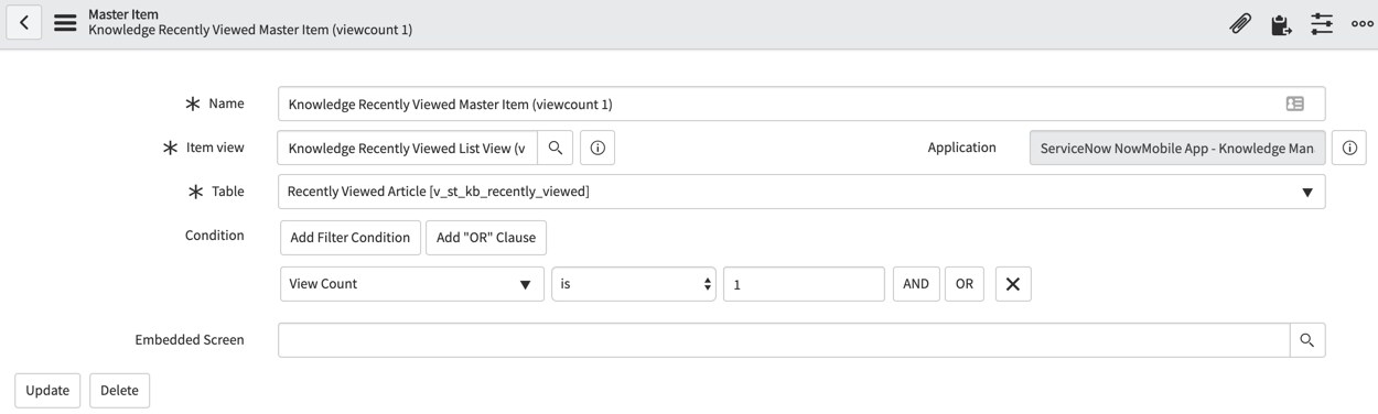

I have requirement to access knowledge articles/ knowledge bases on mobile app.
Currently we have configured Now mobile as well as Agent Mobile App.
but when I enter something in the search, I am not able to see kb article results.
also Information tab shows up to be blank.
What additional configuration needs to be done to display the kb articles and knowledge bases here?
