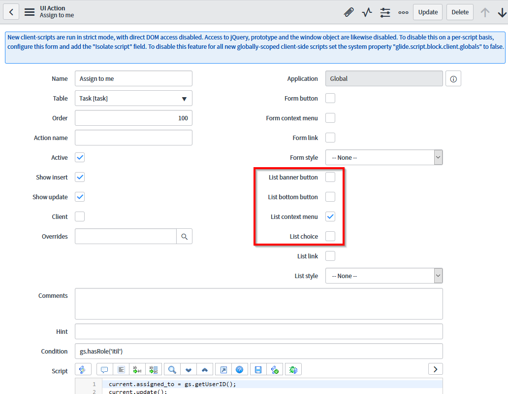

DirkRedeker
Hi Bart
You can show the UI Action, that you already have on your details form, also on the "List".
Here select the "UI Action" Tab
Select the UI Action, that you want to show...
Select the option, where and how you want to see the button appear on your list.
Hit Update and check if the UI Action works as expected (first try in NON-Production !!)
BR
Dirk
