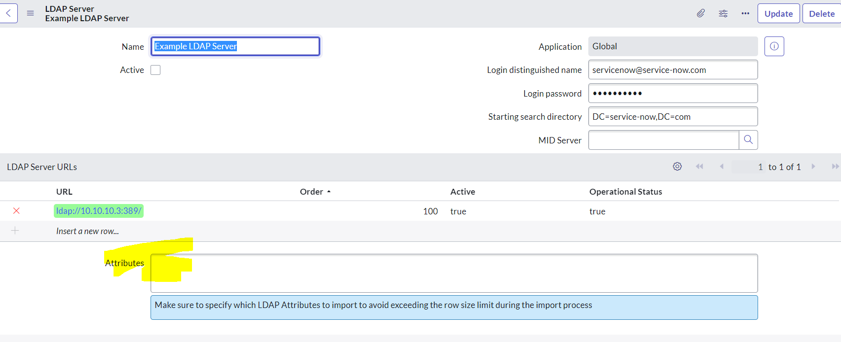

Navigate to System LDAP >> LDAP Server
Open the specific LDAP Entry & enter the attribute in Attribute field as commas separated name.

But when I check my LDAP server, there are MORE THAN 17 attributes present in the Attributes field with comma separated. But my doubt is in the LDAP Transform only 17 fields are mapped from source to target. So, do we need to include the required field in transform map mapping?
Lucky
If you have already added the required attribute in the Attribute field then it should be able to pull information for that attribute.
Yes, for Transform map you need to map for the the attribute to the required field accordingly. It will automatically create field in staging table but the mapping will have to be done manually.
