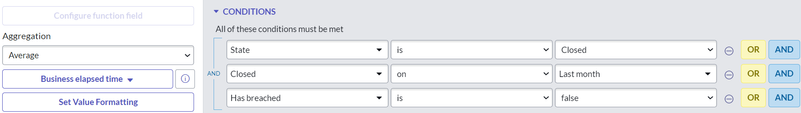

I need to generate a report with the % of incidents met response SLA. I have chosen table as incident.SLA and put the conditions as has breached is false. It is showing the time with the below screenshot conditions. What should i select in the aggregation to get the % ?
Please refer the below screenshot and help me with this.

This functionality is not possible with the Reports. But Yes PA plugin helps to get this done.

If you would like to have a report specifically displays the percentage, you may need PA to achieve it.
Required Plugin: com.snc.pa.itsm_dashboards
Sample:
Name: % Resolved Incidents with Breached SLA
URL: https://<instance_name>.service-now.com/pa_indicators.do?sys_id=25cf7629db8da70047dcfd131d961931
While in the Report Builder, you can leverage the Has Breached field with group by, it will show the count total and the percentage in addition.
Like below.
#Trend
True is Breached, False is NOT Breached.
#Pie Chart
